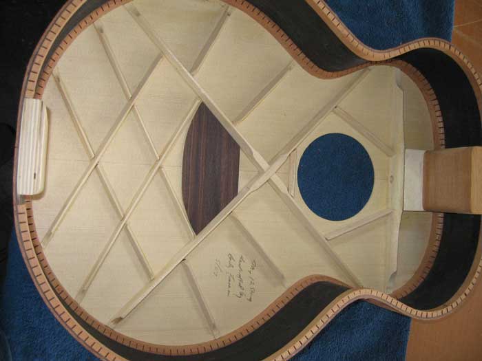

There is always controversy surrounding Ervins methods etc.
I don't want to create any conflict but Paul B asked for a pict of a braced top like they are a secret.
I will show you 2 of mine.
One is from a flamed redwood topped cocobolo OM that I loved!!! (Top pict when not quite completed yet)
The 2nd is from an OLF SJ 12 string that I have had rave reviews over. It is the one that Graham Nash played
Very different bracing schemes!!!!! But I applied principles of his teachings to both tops in different ways
I hope this helps

PostPosted: Mon Oct 29, 2007 12:34 pm
I don't know Ervin but hear great things about his work.
How about a few comments on what I see in this bracing scheme you have going here Andy? Just observations, no critique. We all appreciate your work and enjoy your posts and scrumptious pictures.
Observations:
1. Thin braces, somewhat knife-like
2. Indian Rosewood bridge plate, fairly quartersawn
3. Capped x-brace
4. No scalloping on lower x-braces or tone bars
5. Finger braces are skewed to more naturally divide this area (not 90 degrees off the lower x-brace and parallel)
6. Upper transverse brace is sculpted swooping off a higher center area, then a rapid concave cut near the lining
7. Two variations of lower bout bracing, the first more standard but with a type of two fingerbrace off the single tonebar, the second incorporating some lattice type system, apparently not interlocked as at the x, it's hard to tell
Thanks Andy for sharingBruce Dickey39384.858912037

Thanks for the pics, Andy.
Interesting stuff.

PostPosted: Tue Oct 30, 2007 3:58 am
A lot of my approach is based on basic engineering principles. I never understood the concept of fat braces. The cube rule is so revealing. Also I don't understand the purpose of scallops. A lot do it but it makes no sense to me. Think about how the stiffness changes in the area of a scallop. cube rule in reverse.
Steve Those bracing patterns are mine based on principles that I learned in Ervins class about how a top moves etc. Clearly they are not Ervins. He would be embarassed by my tops. I am trying new things with each guitar. Before the course I would have never tried these different things because I had no knowledge or foundation upon which to create new ideas with some sort of reason behind them.
Hesh I don't use a router. I either shape them on the guitar top with a chisel or pre shape them a bit with my belt sander first. Yes my sides are doubled. I use lower grade EIR for the inside and I dye it black so not to conflict with the back and sides. I like the look of the black sides.
Shane Beautiful Spruce of course...it is yours!!!!
My goals are a balanced moving top. I love the deep tones of a lightly built guitar. That is my preference. it may not be yours.
Ervins teachings give you a foundation upon which you can head in any direction and have a rational plan to achieve it. He doesn't want us to make guitars just like him. What is the point of that (His guitars are nice though)Before his class I didn't have a clue. It was like trying to write a novel without speaking the language. You build from a plan and then what???? You learn a ton about wood structure and top function and dynamics. We looked at tons of bracing schemes from Kashi to ladder. We dissected them to understand how they worked and why some were very successful and some were not. Each guitar is built for a particular reason. In the class we were give assignments to come up with a design based on player requests. Then we had to justify our design and take criticism. An example might be a Parlor with profound base and longer scale. 12 fret. Many were what seemed ridiculous but learning how to think and create a guitar that meets the goals of a customer is priceless.
Make sense?

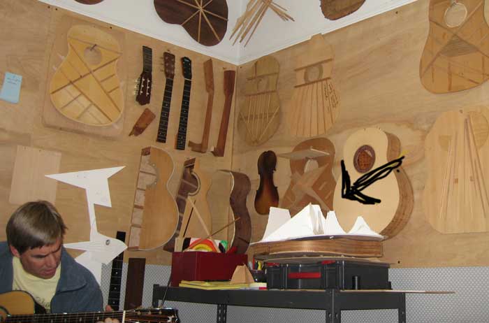

One of the interesting things we did in Ervins class was that we made models based on the the braced tops we brought to class. What we did was create a model to SEE stiffness.
It was eye opening. Most people understand the cube rule but really don't have a mental picture of what it really means in real life.
So we took our tops. I used one that I brought in and we picked a unit for size   Then based on the cube rule we converted that to stiffness. We then made foam tops representing the stiffness in our actual tops. It was eye opening to see how the stiffness was changing in the top I brought.   MASSIVE peaks and valleys. Try it some time on one of your tops.
This lesson is hard to describe but you really have to see it to believe it. I will look for a picture.
PostPosted: Tue Oct 30, 2007 6:03 am
Here is a Steve S playing my worst guitar. BUT
look at the arrow. It shows a foam top somewhat representative of a typical top showing stiffness.
Interesting
PostPosted: Tue Oct 30, 2007 6:30 am
Posts: 1271
There's also a plywood model representing brace stiffness on the wall behind the foam one.  That one may be easier to see.
And don't miss Ringo's cardboard Picasso guitar player behind Steve!
